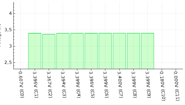

I was finishing my build and accidentally shorted my DieBieMS. I’m not really good with advanced electronicis so I’m looking for someone in Europe to help me figure out what part was damaged and how to fix it. Everything works except for detection of first cell voltage.
Also if someone has a DieBieMS for sale ill gladly buy it. I’ll try to fix my old one but will need another sooner or later so why not to have 2.
photo of the DieBieMS tool - shows wrong voltage in first cell
diebiems
Wait, you run a 9S setup?
Pull out your multimeter and check the lead which is the faulty cell. Follow it to the bleed resistor all the way to the balancing IC. Should give you a clue whats wrong.
10S setup C0-C9 so C0 is the faulty one. Will try
