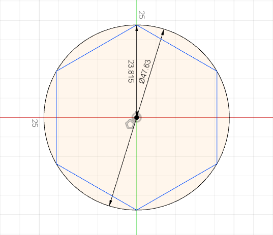

I need to cnc some pulleys so looking for the distance between center to bolt center on thiller 6 shooters.
Anyone know what it is?
I do, ill pm you it soon
Thanks mate!
47.630 mm circle
In a hexagon shape. Holes are m4
Thanks mate! Are you sure they are m4? Seems small
100% M4, the wheel side is threaded so you just need to make the pulley part 4mm
Awesome! Thanks again
The bolt pattern is exactly the same as vex robotics pulleys. You can go to their site and find drawings there too.

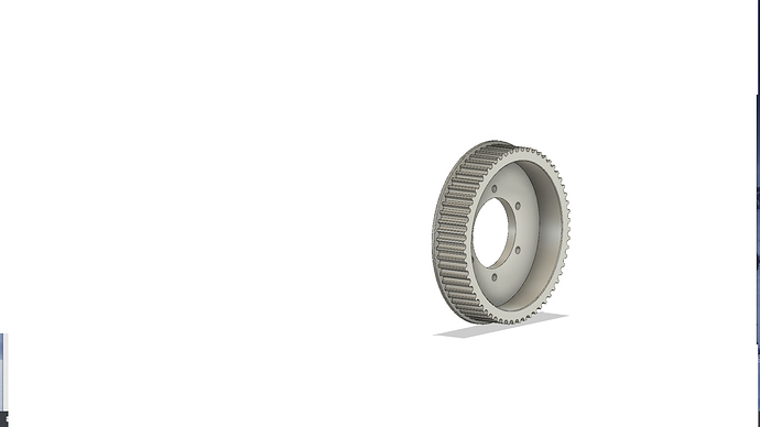

I’m excited too see this.
Do you want to see the final product or the CNC porn? :sweat_smile:
I do !!! :raising_hand_man:t4:
I do too!!! … even though I don’t do ATs :sweat_smile:
You ever get too make these
