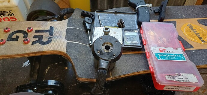

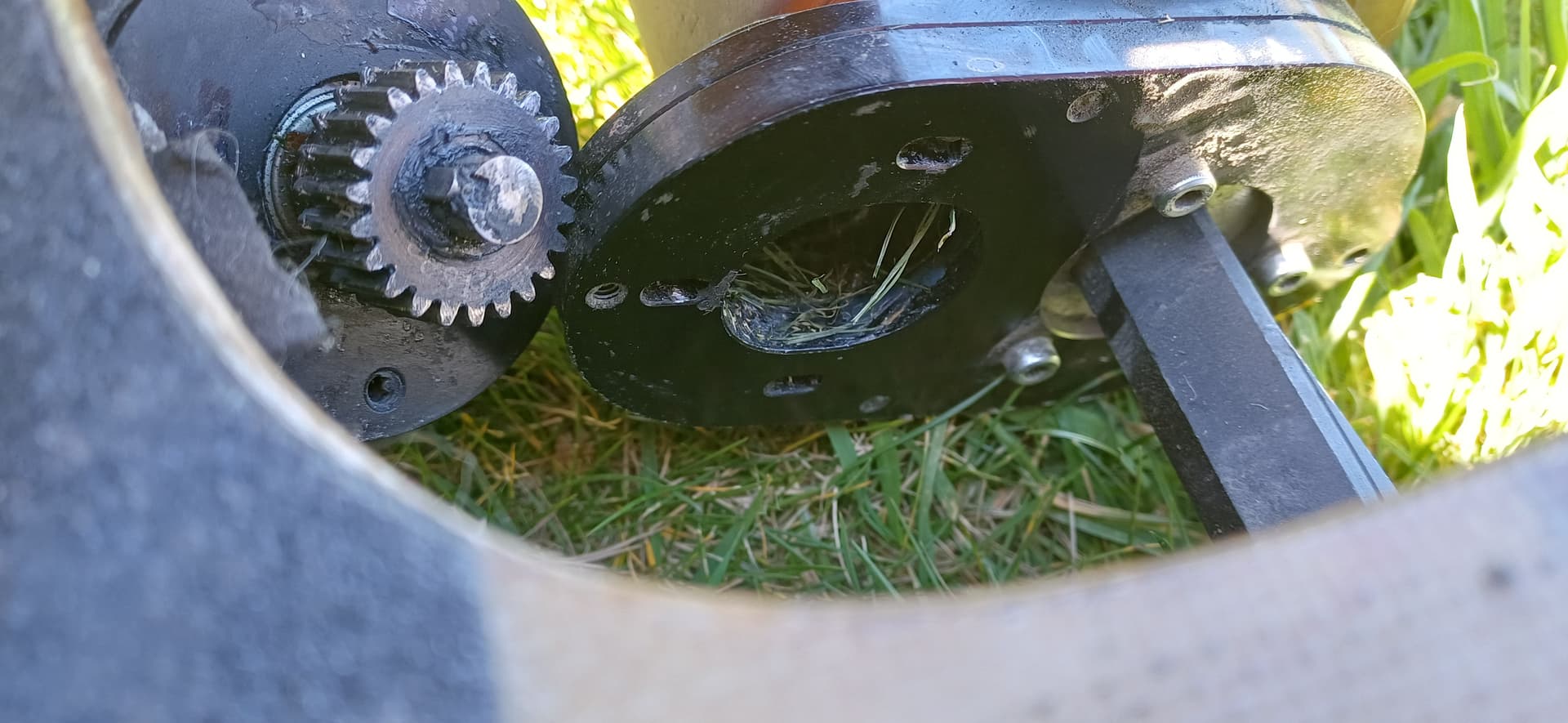

My street gears flew apart on Thursday night.
The 3x M4 screws tore the threads out of the aluminum 6384 motors and played hell with the gear teeth as this happened at about 55kmh.
Are 6384’s just too heavy to swing off three M4 screws? I’m hoping helicoils are the solution.
Thanks for sharing that gear file though. I might be needing it.
It was M1 thread so got confused.
88TMod1.PDF (182.3 KB)
Why 3 M4 screws and not the intended four?
Also, they’re sensitive to thread engagement. FS6384 I believe are a little shallow; tapped 5mm deep.

From memory there were only three spots to put the screws in? Maybe I missed something that should have been obvious, I’ll check shortly. I need to pick up dead board, and drop off a couple GTR’s so old mate can take his new gf for a skate in the park.

Just checked, three holes only.

I recall the reasoning being that it rotated the motor 45deg for better feeding of phase cables.

The helicoils went okay, and I swapped the M4x 8 screws with M4x10. The holes aren’t blind, but obviously there are cables to be careful of.
This is actually really important, and often overlooked.
