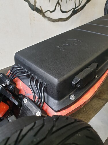

I like these individual cable grommets. They are a little tricky to install tho. Pro tip: soak them in boiling water immediately before install.
Sounds like you should desolder the MR60 and feed the wires through the enclosure then, resolder the MR60, then epoxy the wires in place. Add fumed silica thickener to the epoxy and then after that cures you can cover it with a thin layer of runny epoxy to smooth it out if you want to.
That’s a possible solution, Brian. @glyphiks got a link for those gromets?
Edit:
Something like this would work, no?
Those ones are blank, so you need to cut your own hole, but yeah, same shit. I just get them from the local auto store
Yeah, those will work, or you can get ones with holes already molded in them.
If you desolder the MR60s and just run the individual wires, you can also get cable glands with multiple smaller holes like this one.
Brilliant thx @b264 @rosco @glyphiks and @MysticalDork :beers:
