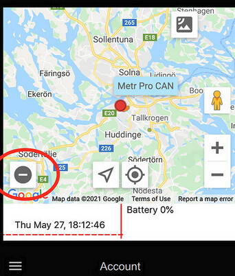

Correct, with this setup you could leave your phone at home and still record everything that needs to be recorded. The Phone obviously is required if you want to change settings mid-ride. Recorded rides can be synced later when module gets connection to the phone.
Metr LTE requires either a Metr Pro or Metr CAN to work as it is an addon to the eco-system.
With Metr LTE you can have a constant connection to the location and limited data about your board(technically no matter where you are in the world, even if the board is on the other side), as long as it is powered on. (Like a live GPS tracker but with Data) What you can also do is lock your board. I like to use theft as an example.
If someone mugs you and steals your board with remote and drives off, you can go into the metr app and check the constant location and lock the board aka disable the throttle, only brakes will work. “making him unable to drive off/utilize the board.”
grafik
grafik
i probably have missed some stuff.
No anti theft self destruct switch? Lame. Guess I can manually set batt amps to 300.
