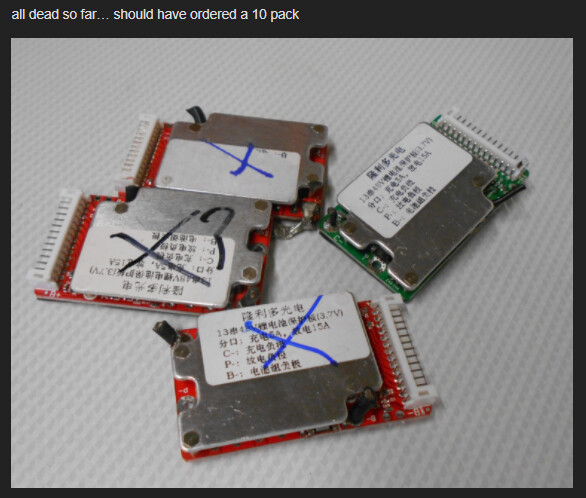

if your a noob I recommend buying a multipack of BMSs , I think I killed 3 on my 1st battery build, I’ve killed about 8 now - few years on I still always buy 2 when I need 1 and I’m still scared to touch my DieByeBMS as I don’t think it would survive me… recently tried making a 13s smart bms a 12s and blow it up lol
I’d be scared to ride the boards with your batteries in them​:joy::joy: did 3 packs and the BMS’s all survived so far but it’s a good advice to get more just in case
oh dear it was more than 3
I mean I’m not that surprised those died tbh I took appart 5 overboard packs with what seems to be the same BMS and those little shits killed only a single series connection in all 5 packs
I hate those things with a passion lol never go cheap on a BMS however much you might think your saving :slight_smile:
You gonna save in the end, if your pack last long
