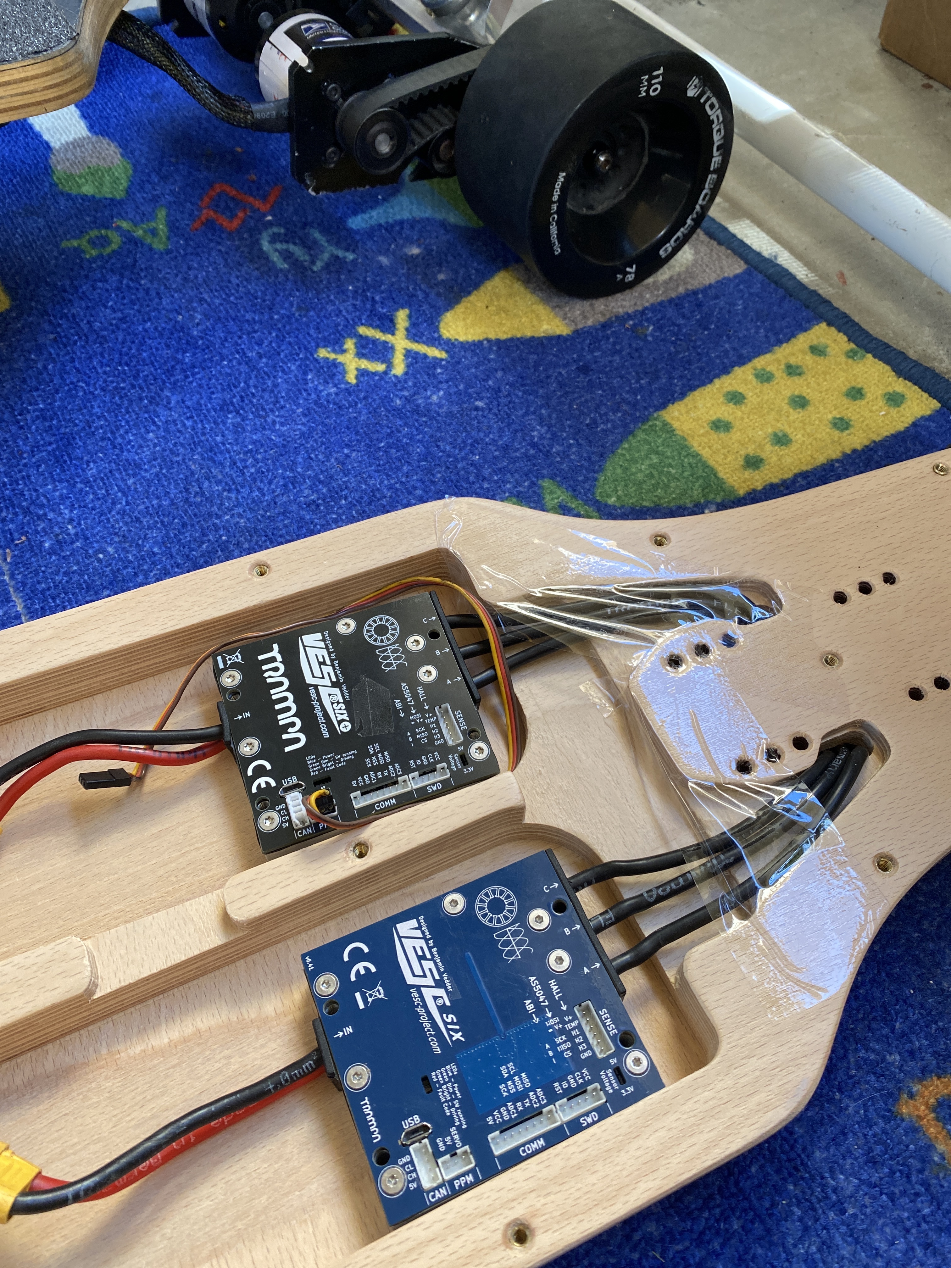

  • 2 vesc 6’s, plenty of space to put em-Have

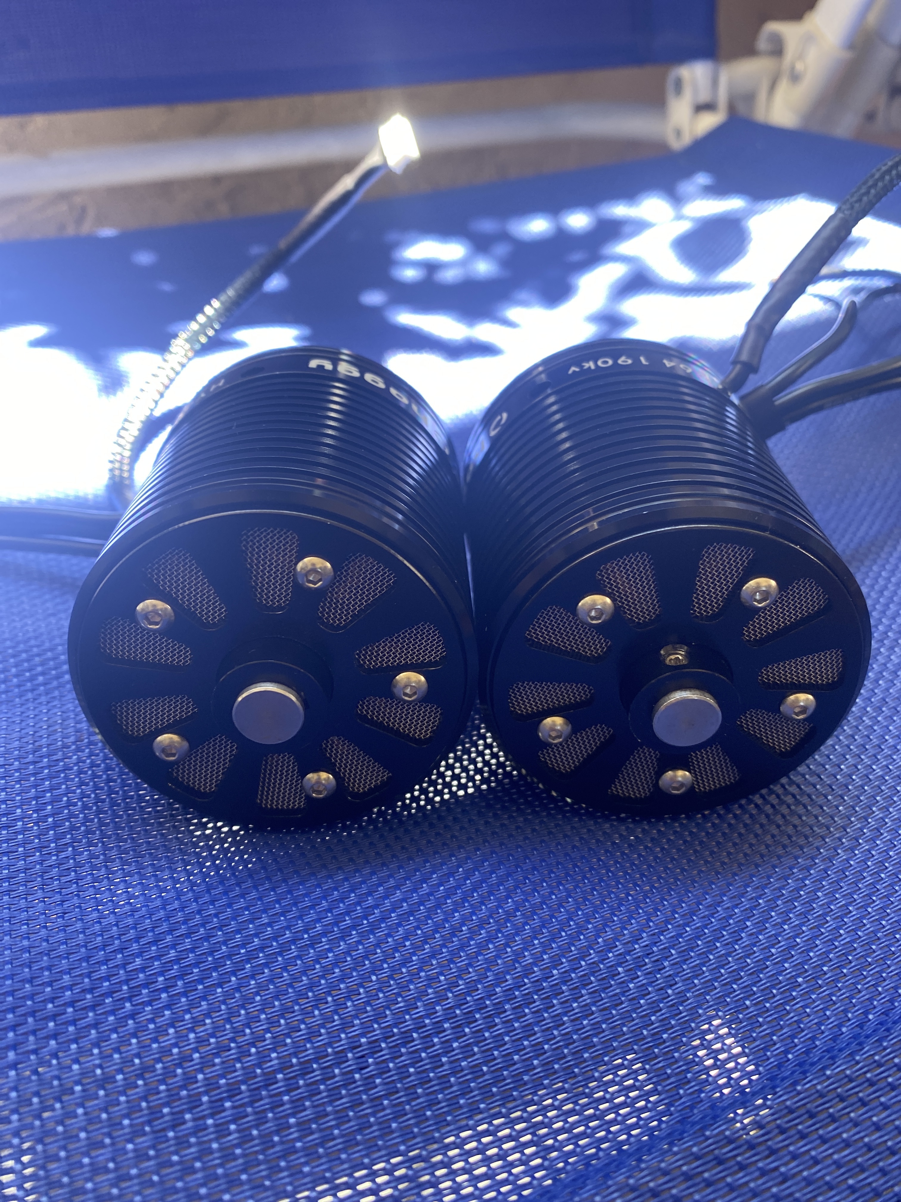

  • 2 haggy 6364 sealed motors-Bought

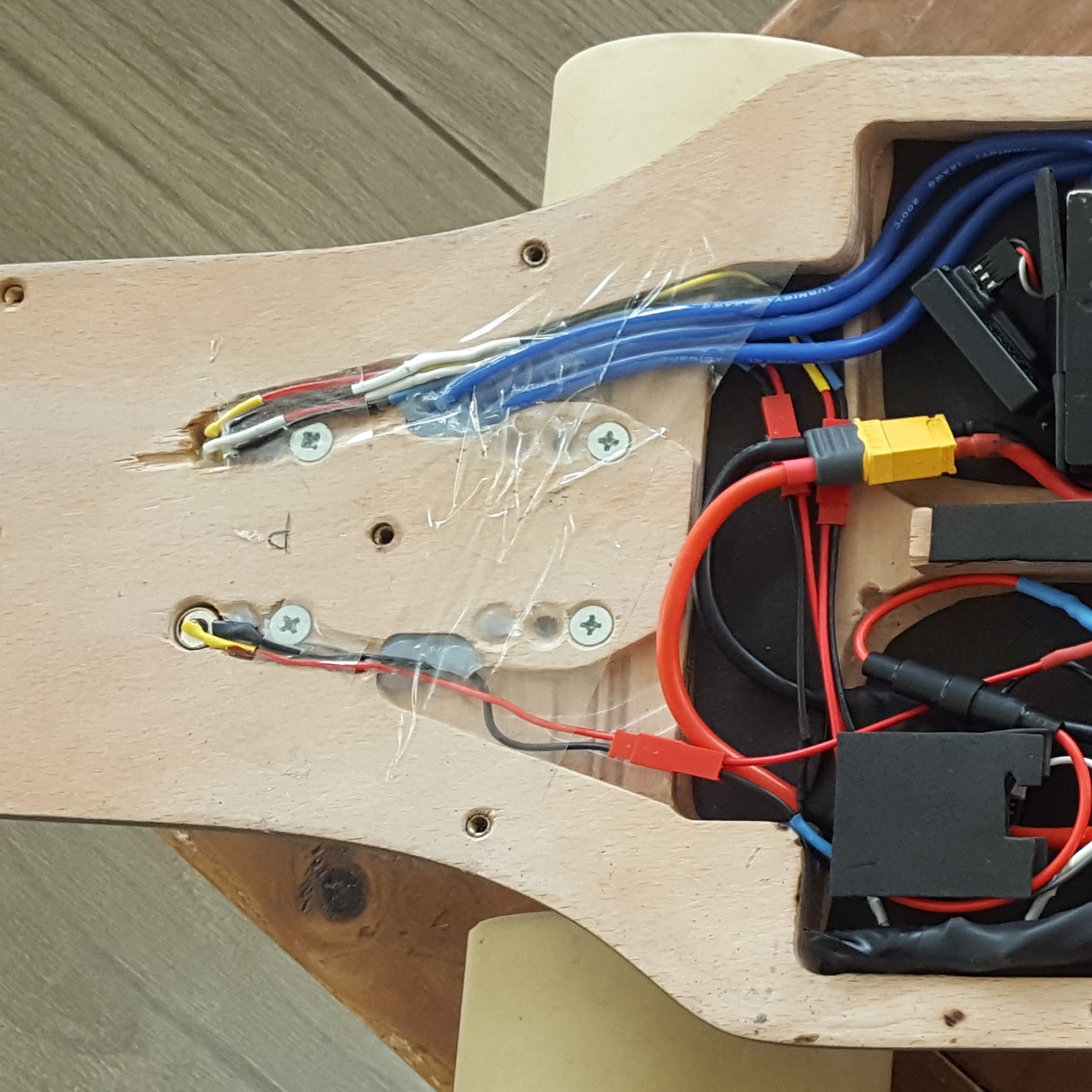

How have u guys routed wires and everything?
@bevilacqua @Skyart @Bindings_McGee @dougpage @rusins
Do you mean the power-button/charger port wires?
‎ Yep!

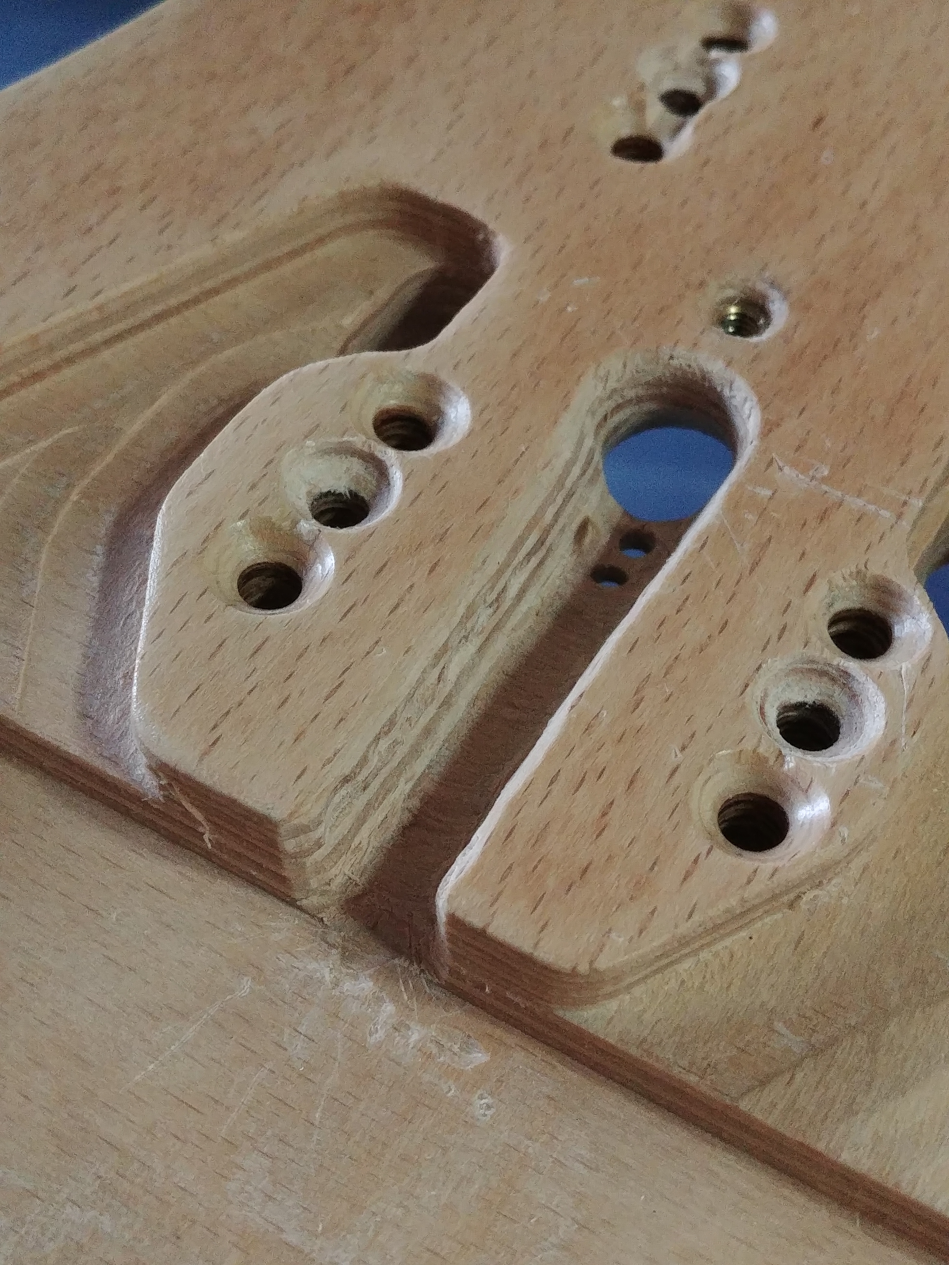

I always prefer wiring them through the baseplates, it keeps it nice and tidy. But others have chosen different ways (You should be able to find pics for them in this forum or the old one)
powerbutton and chargeport are in the baseplates

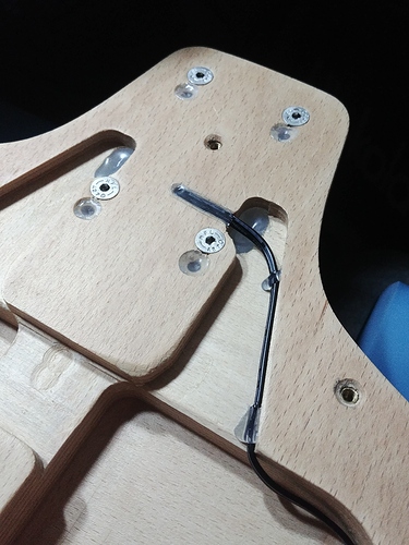

powerbutton cable channel
this channel is for the phase cables and charging cables
(everything is still work in progress as I’m not finished yet)

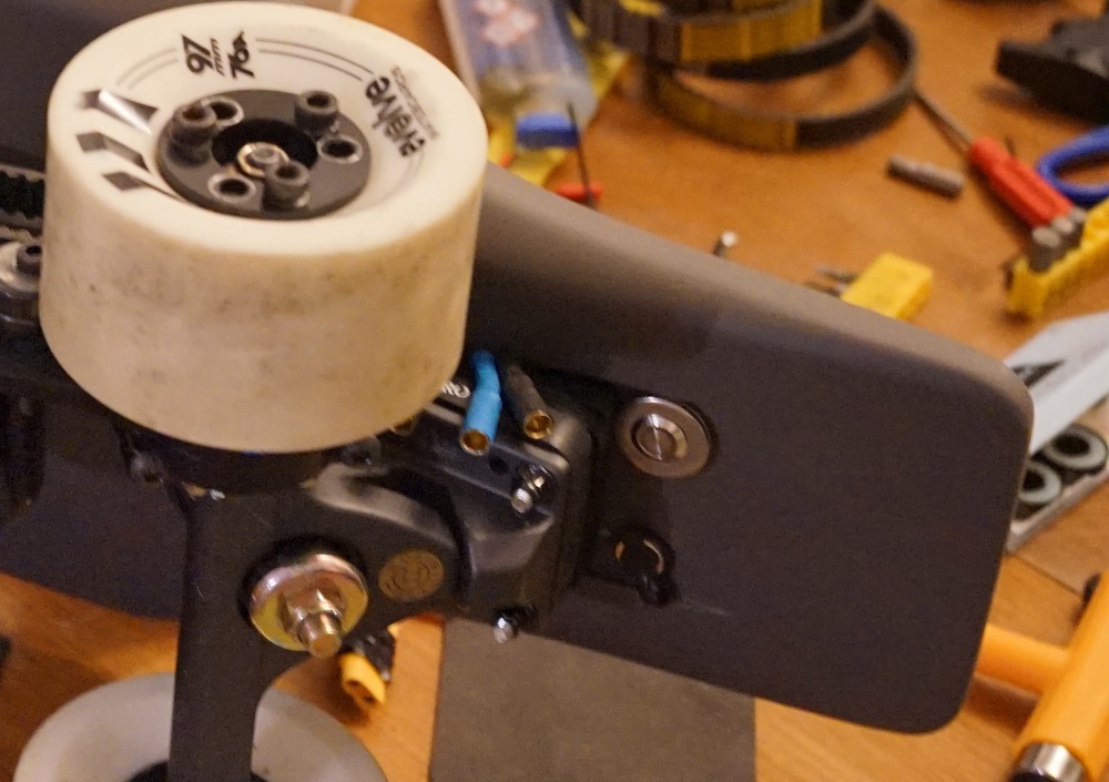

What power switch is that?
I ordered it online; but it’s the exact same one that comes with the Flipsky pro smart enhanced magical whatever the one that actually works anti-spark switch. As you can see, it’s still too tall, so I had to use some washers.

Just got the motors from @CiscoV and they look so nice!
Little update, completed the drivetrain and motor wiring to inside the deck
