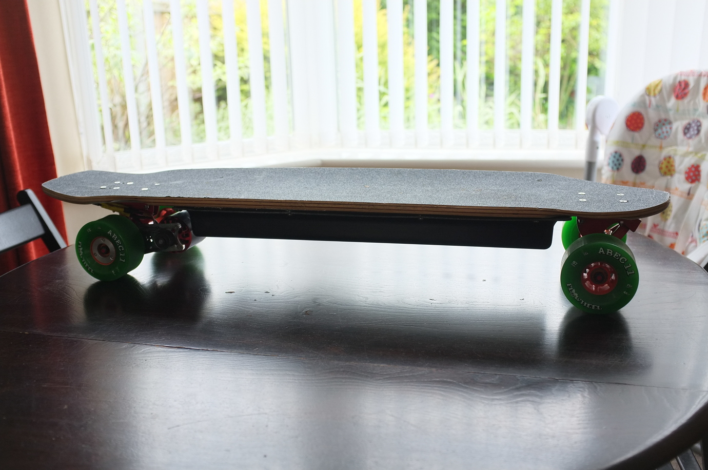

Hi all,
I’m planning to add two 10s2p meepo V2 batteries in parallel to this board.
I was initially gonna add a couple of lipos to it however I found the two meepo packs on Facebook for £40 :grinning:
I know the batteries are meant to be crap, but I am hoping that they might be alright connected in parallel, and this is a spare deck that I just want up and running so I am not too concerned with performance.
The enclosure in the pic is now on a different deck, so I’m looking for another one for this build. Can anyone recommend a cheap enclosure
(I am UK based) that I could house the two meepo batteries in which are 40mm thick?
Also, I’m looking for a remote for this setup too. Any recommendations for a cheap, reliable thumb controlled remote?
Thanks.
