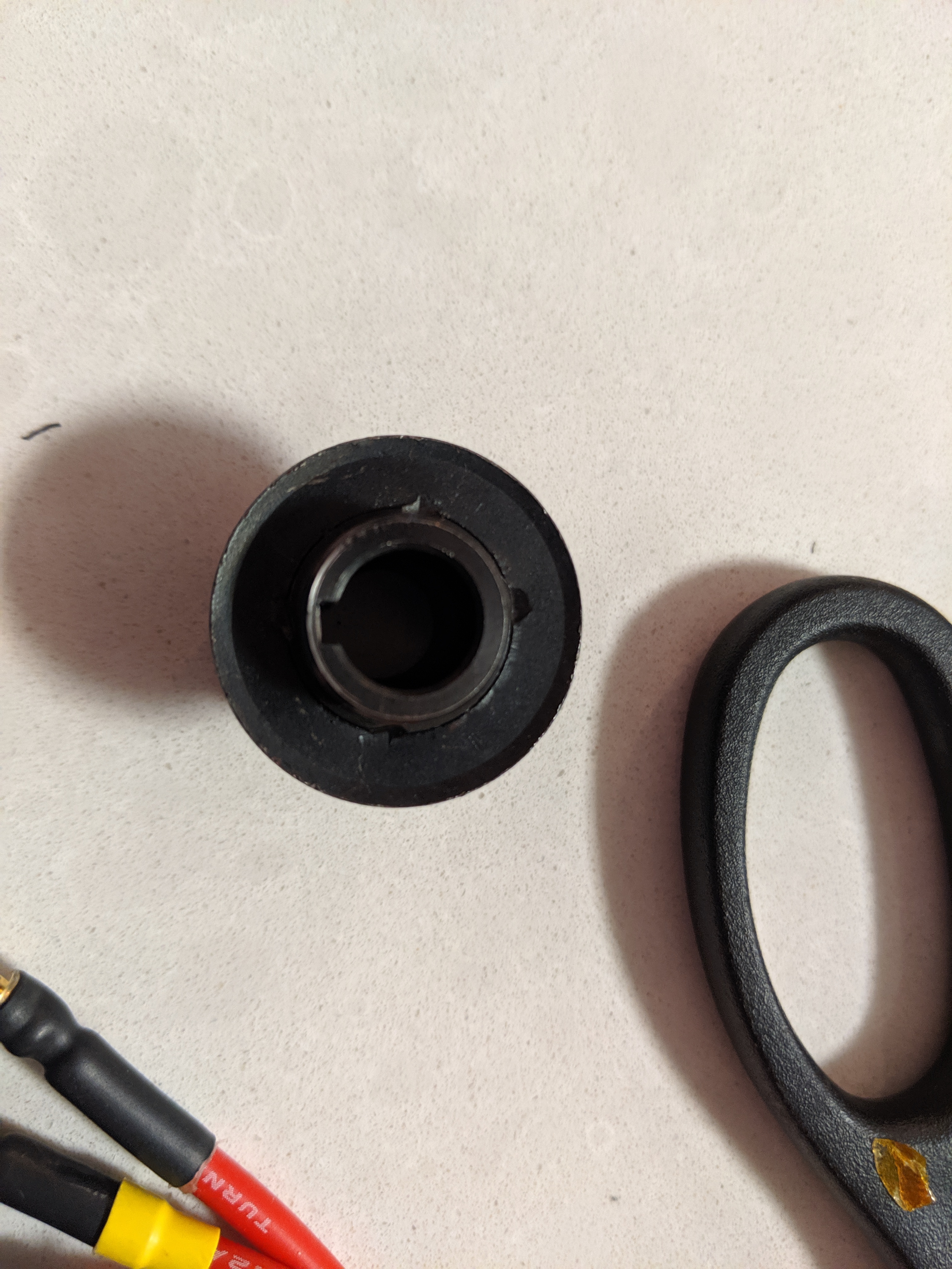

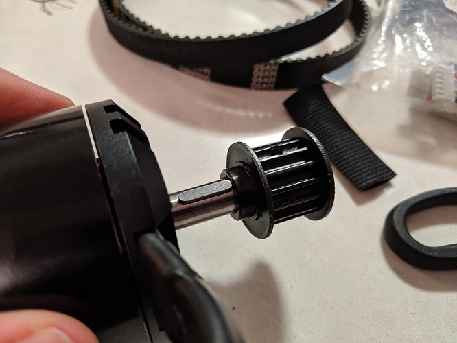

Anyone had any issues with aps pulleys and the 6384 10mm combo? I can’t seem to force the pulley on over the keyway. The slot in the pulleys look really badly machined

Just use the set screw and place it over the cut out of the keyway plus red loctite. Should be more than good.
If you want to use keyway non the less, dremel the keyway a bit to your needs.

Took your advice and used the Dremel to shave of about a mm from the key.
Seems to be holding up ok, will perhaps take them apart and “battle harden” them as you suggest.
