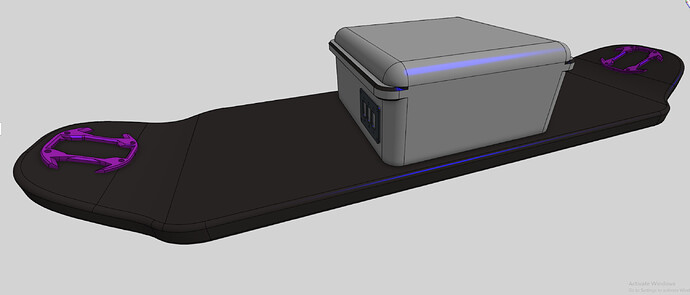

The Idea behind this revamp is to make it basically a full blown mountain board
Tearing the bottom 12S10 off.. and Top mounting a Battery that is removeable,
I’m a bit of a boater / Sailor & part of the reason I got into esk8 is because I used to sail to Catalina island a lot & wanted a way to Cruise around. I stayed on the the backside of two harbors. Sometimes I would like leave my boat there and take the ferry back to San Pedro so it was already there when I wanted to come back the following weekend.
But the ferry rules are pretty strict on Li-ion batteries being on the ferry going to and from catalina Island.
So I want to basically run Everything inside the case I just bought to throw it in my backpack and Basically play it off as a push board.
Course the Motor Mounts would come off too, with the motors attached & Id stow those away.

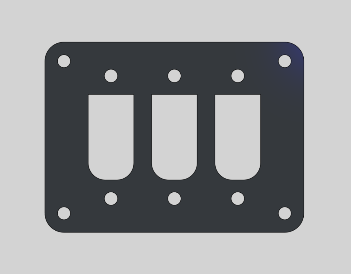

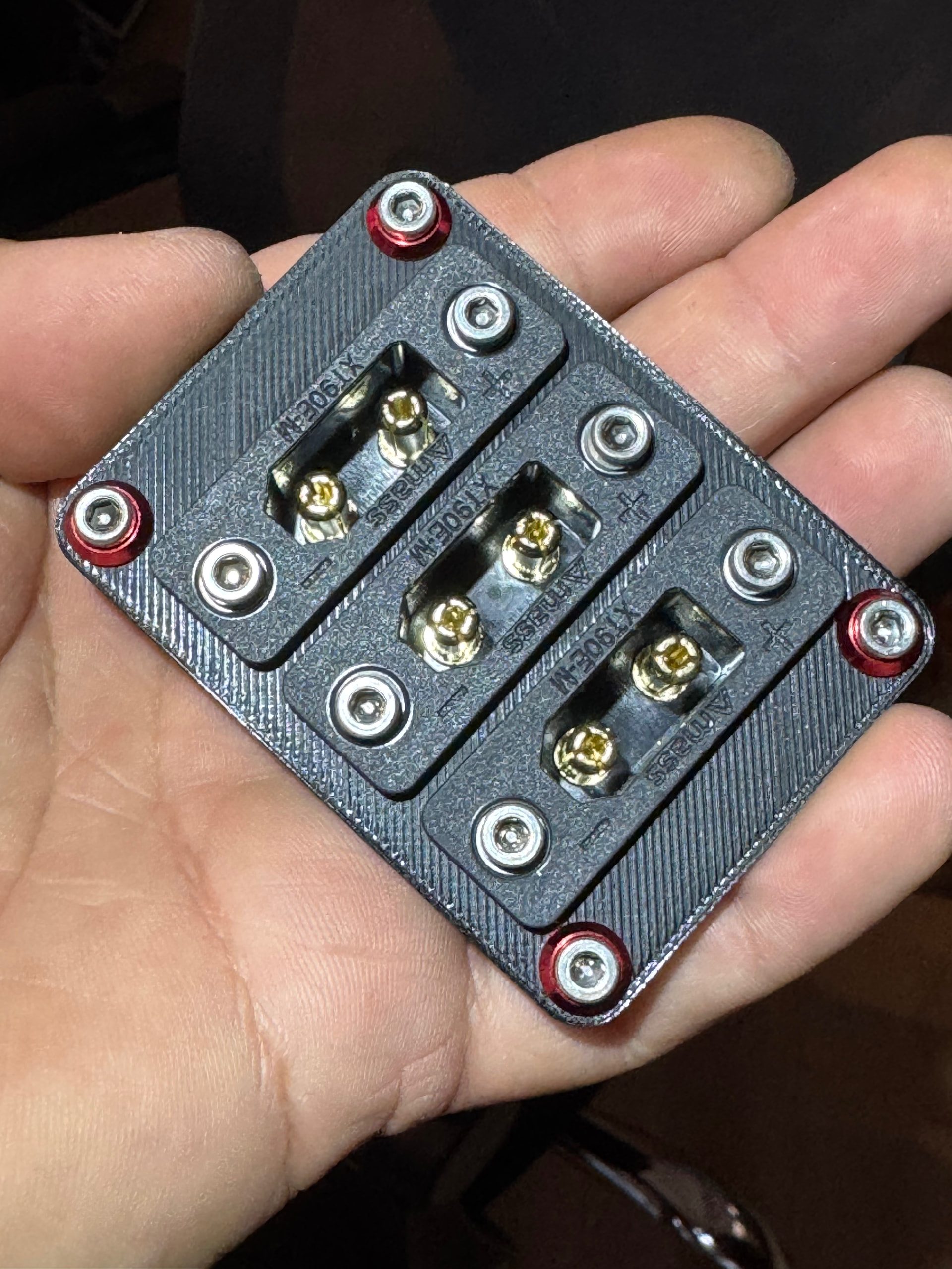

DV6 Pro + BMS + only run Phase wires out through a panel mount idea I have
using 3 Xt90S
(Basically running one motors Phases through all the Positive bullet
& running the Other motors Phases through the Negative bullets
Sounds Shotty but I’m positive it’ll work totally fine,
I just figure why spend money and time trying to source a oddball oversized MR60 Panel Mount connector or similar)
Couplah Sandals to go with it
(TPU Dust Cover)
Xt90S is the antispark version
There’s no need for antispark in this use case… might save you a couple bucks
And the regular XT90 has higher current handling capability because the bullets are longer. Though it’d probably only matter for a raceboard.
Yeah I already have a lot of both. :grinning_cat_with_smiling_eyes:
Interesting :open_mouth:
I’ll be using the regular ones then
Alright there’s no denying the plans keep changing for this thing….
Thinking internal 20s6p (maybe) but definitely want 20s
Tito trucks because I haven’t got a set of those yet :smiley:
Fitting up my B1-AT drives (will have to ask Tito to make new mount couplings)
