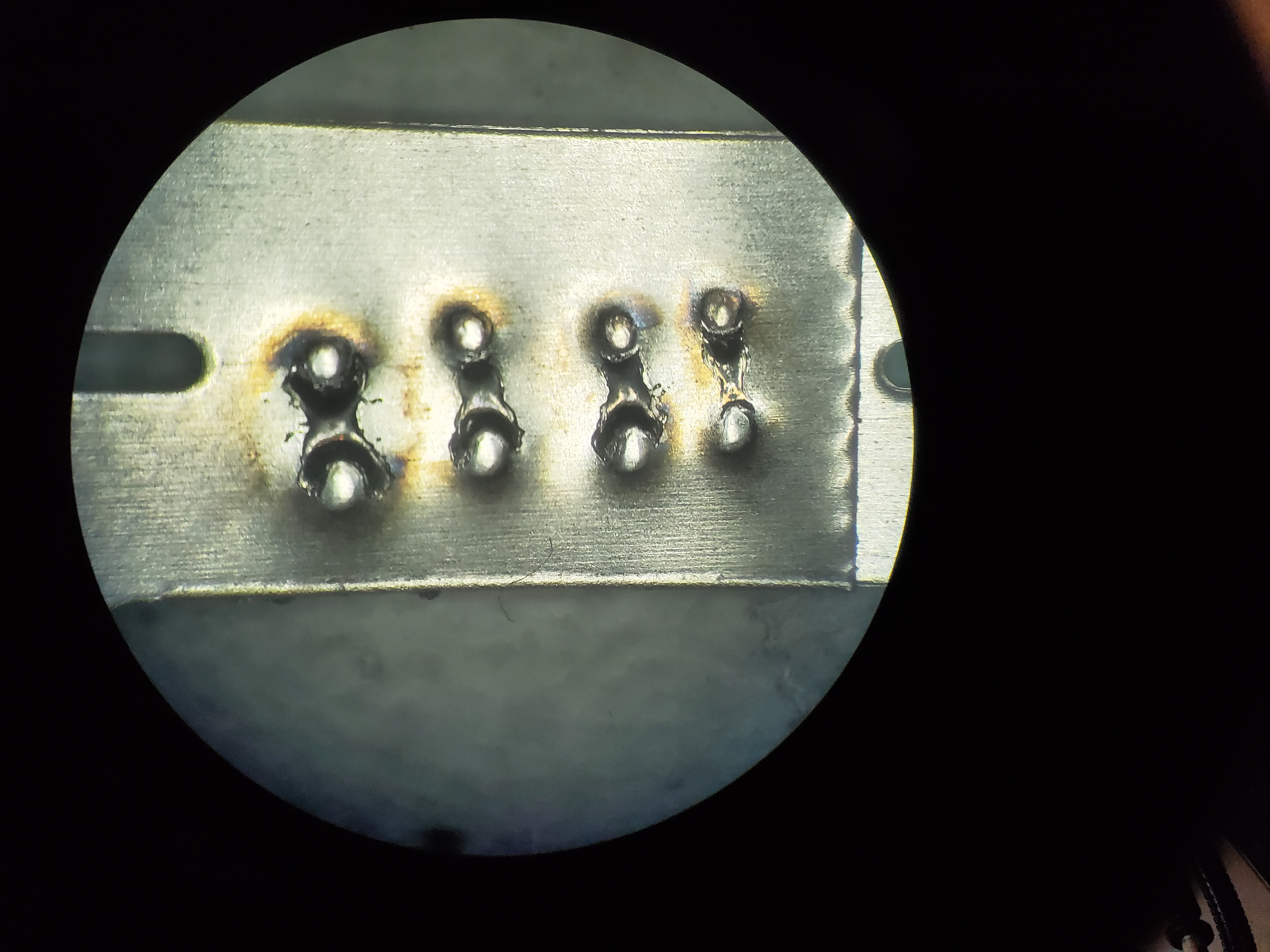

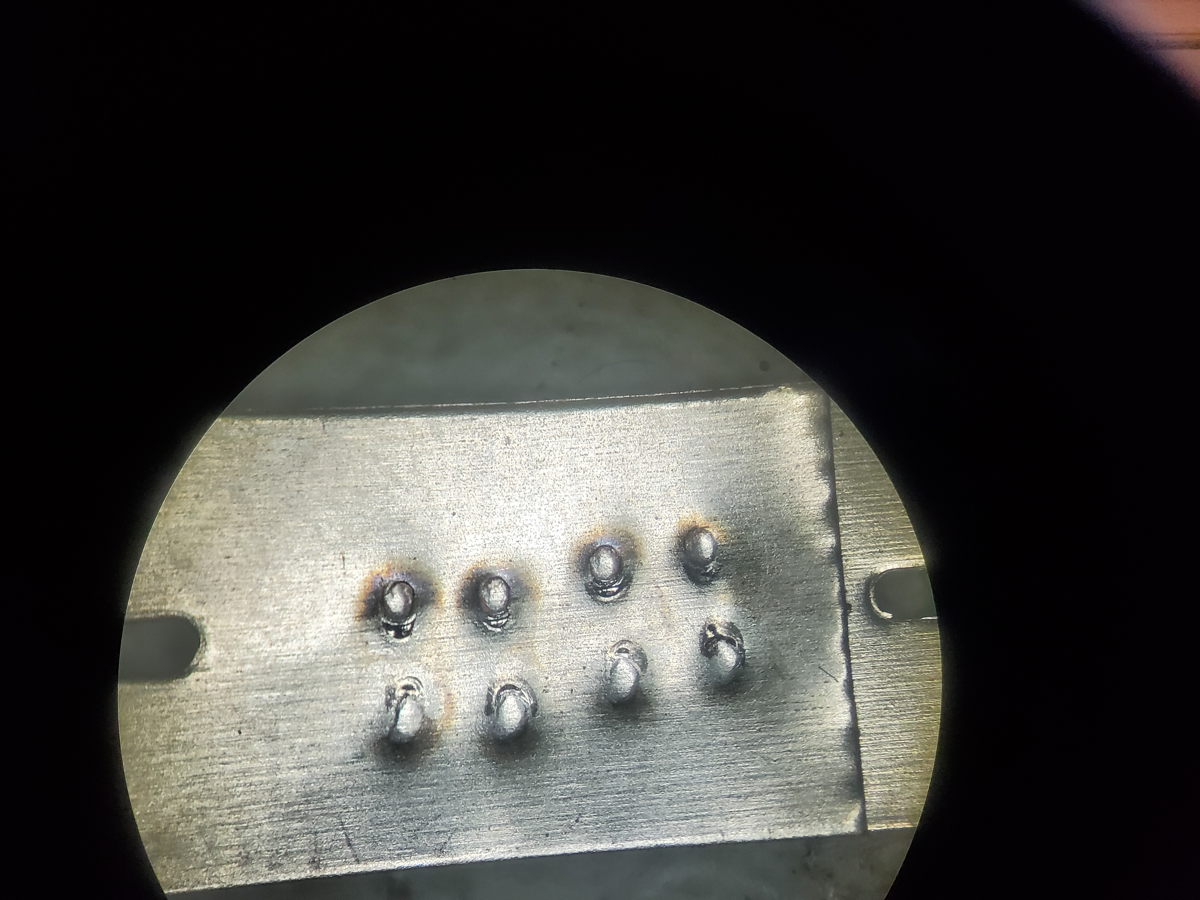

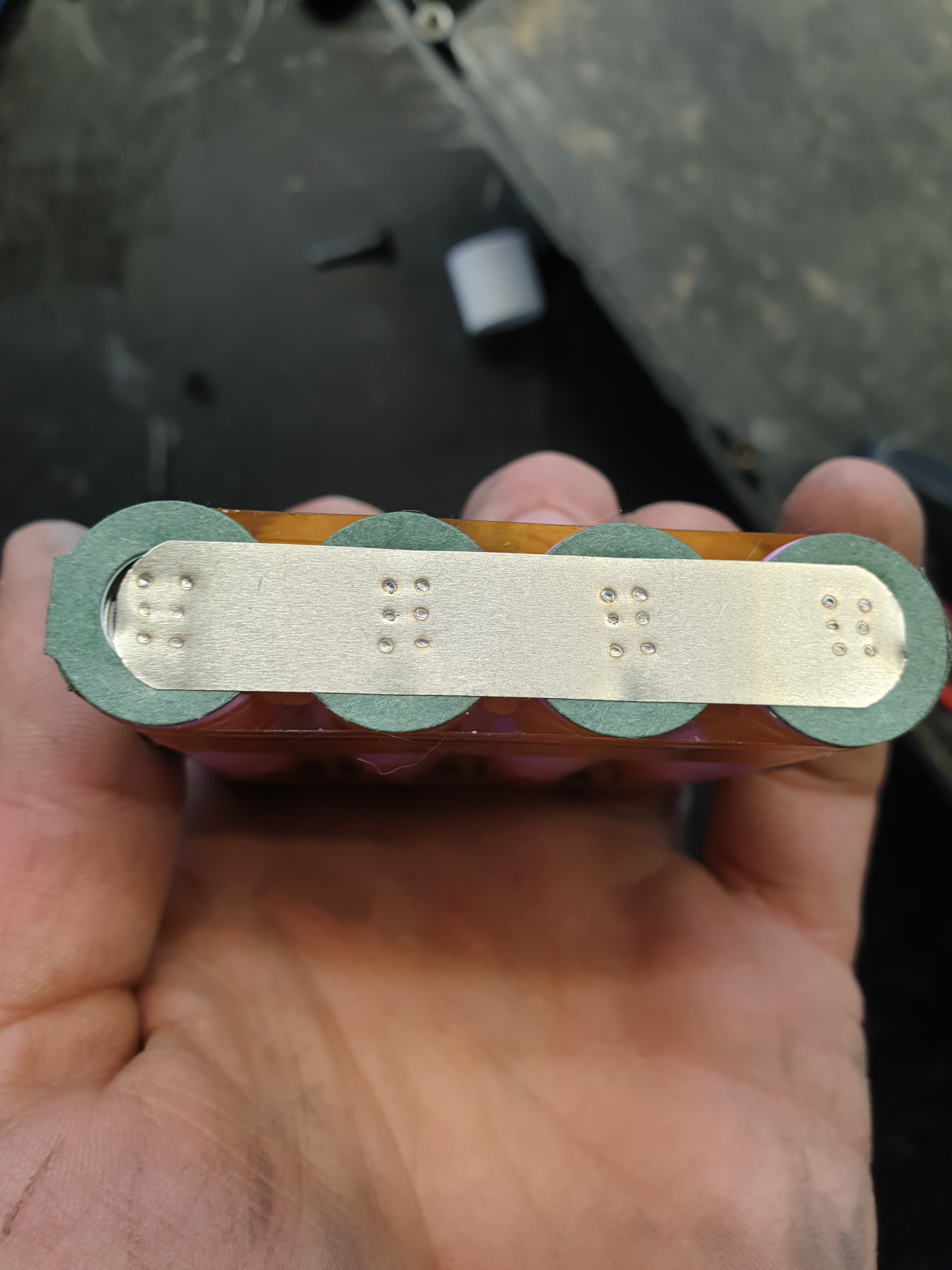

A man makes welds with two settings. Which one is "better"? Is either "good"?
What does a good weld look like? Does it look like either of these?
It looks like your settings are too high on both of them dude, try wind it back a bit
So no melt marks at all? I’ll take 10-15% off er then.
Aim for just the slightest amount of the ‘burnt’ look
