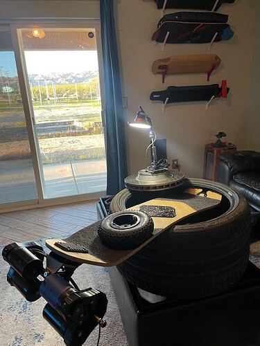

New work stand and lamp base. Why? It’s too hot to fuck around in the garage.
Rotors were more difficult to drill and tap than I suspect. If I wasn’t 2yrs into this project, I’d take a detour and visit the Rennlist forums and ask them what KV their motors are.

Annealing PPS at 250f for 3 hours.
A relative kings ransom of calories expended for 40mm extra axle. The small semi cylinder with spline marks that match the old stock shaft is all that’s left of the other stock axle.
@mbs, I saw the poll for truck width. Give me more axle length without ground in steps any day. If it’s too long, I’ll cut and tap myself.
Ain’t no one here ever bitched about axles that were tooo big.
(New axles are trampa 12mm)

Assemble!
(Don’t bother counting. It’s 14. Don’t judge)

2P2WD :boom:
Love it! However i hope these drives arent going to break in the first 10 kms.
Maybe, probably. But this is just a tribute.
