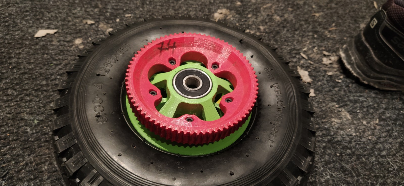

Got the new 18mm negative offset rims out of the printer this morning and tested the fit.
Here’s the -18mm offset rim on the left and the zero offset rim on the right.
At least the wheel now has space to spin without rubbing against the motor mount plate.
But it still needs a couple millis more negative offset as the motor axle hits the tire and that’s without the gear on, it also limits the movement on how close you can move the motor, so you have less space to fine tune the belt tension with the motor distance.
Looks already pretty deep, but as a prototype test piece, I’ll do one with 5-7mm more offset.
The big wheels do look pretty impressive on the board I gotta say. Most likely I would run something like -8mm offset for the front rims, just to get a little bit more playroom for the wheels to turn and not risk a wheelbite and based on the current -18mm rim, a bit more for the back rims, to be able to fit the gears and belts without too much clearance issue.
So I increased the negative offset from -18mm to -24mm for the next rim prototype. Apart from a slight extrusion problem towards the end that caused bad enough layer filling and adhesion that the very end of the back side rim cracked off, they came out quite nicely. That’s why the back bearing is half exposed.
But at least we have enough clearance now to get the motor on with the drive gear and belt, so mission accomplished, now to figure out the additional mechanical design to be able to fit a gear to it.
Guess I’ll pickup two more wheels next week, so I can get them on the front also.
EDIT: I’ll testing the gear attachment with my current 68T HTD5M gear, that uses the superstar rim bolt hole pattern to attach to the rim. I’ll probably make a bigger gear later, as this increase in the wheel diameter results in a lower torque, higher speed gear ratio with the same gear tooth counts.
It’s on and it fits.
I was running the old rims and tyres with a ~190mm effective wheel dia. and 20:71 gear ratio, giving a final drive of ~168mm / motor revolution. I checked what gears I had for this setup, so I could stay near that final drive number, so I’m assuming 250mm effective wheel dia. and then with 16:74 gear ratio it should end up as ~170mm / motor revolution, so the torque and speed should stay about the same.
I remodeled the back rim to have a mounting hole pattern that is identical to the superstar rim bolts, as I can now use directly my superstar wheel gears on this.
Needed to space out the gear a little bit, so I printed little spacers.

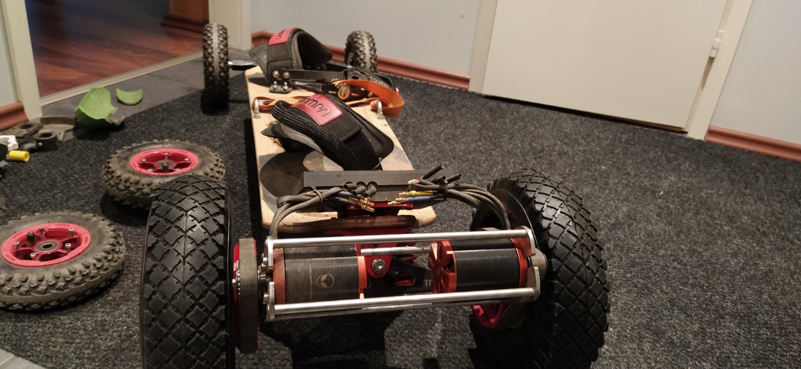

The best thing about 3d-printing is just the speed at which you can iterate your designs. I started with the first rim prototype a week ago and I already have iterated enough that I have a design that is ready for field testing. Biggest limiting factor has been the printing speed.
The rear is ready for testing.
I’m running out of filament and I only bought 5 bearings in total for testing, so I need more of them as well, but I think I’ll do a little test ride with the rear being as shown.
