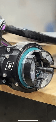

Looking for this 3d printed adapter skp/servisas to berg three spoke? if anyone has it, it would save me some time.
Please, send me the links to the files=))
Sweet action. Are the finality angles risers compatible with hypertrucks?

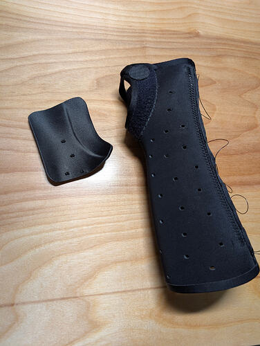

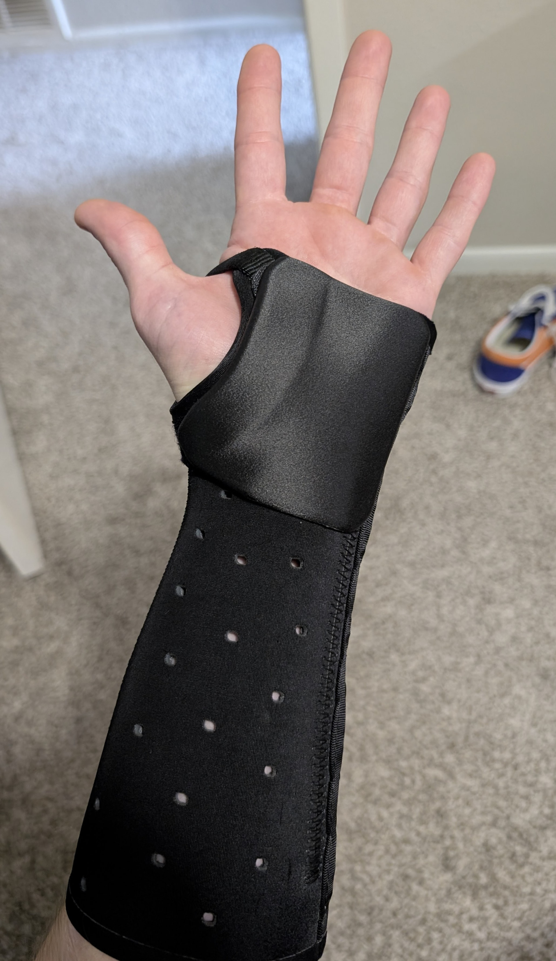

Made a palm skid plate for my Exos wrist brace. Took a bunch of photos to make a model in RealityScan, then t-spline modeled it to shape. Printed in CF-PA612
You, uh, test it out yet?
Hasn’t seen a real wipeout yet, but it’s tough and snug. It’s mainly to keep the brace’s fabric from getting torn up, no colemans or anything.

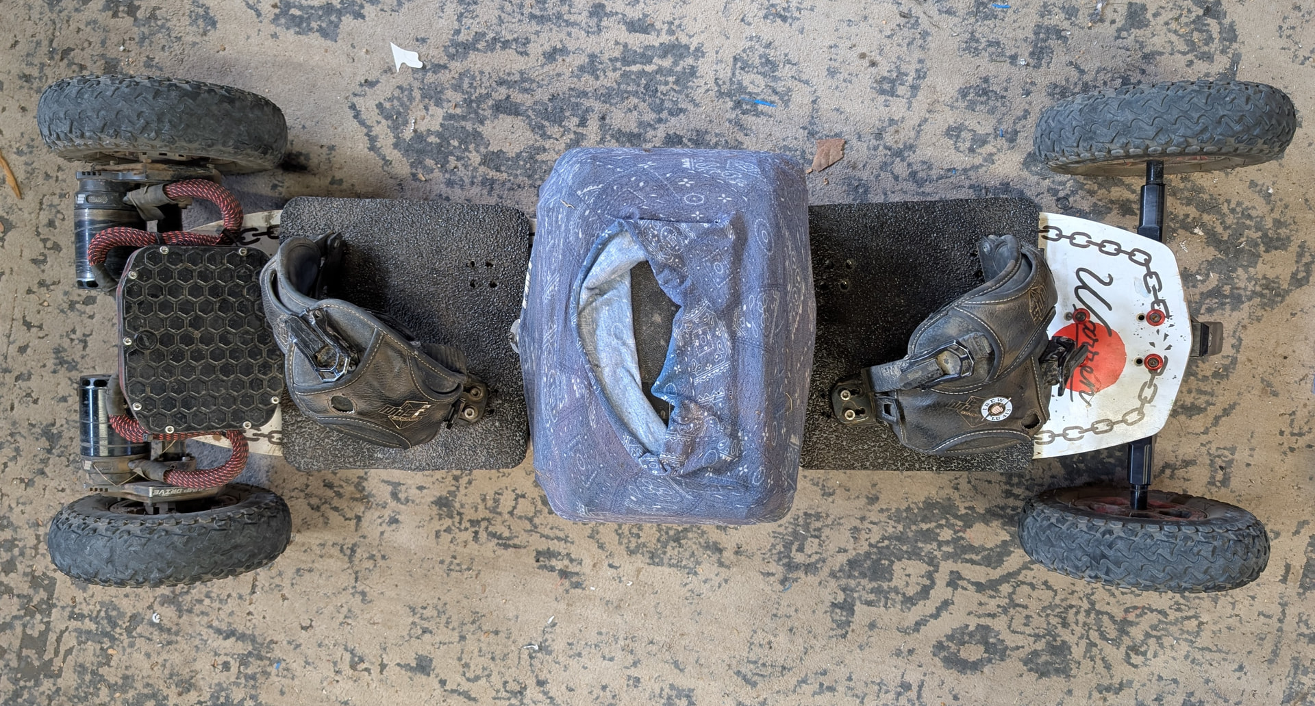

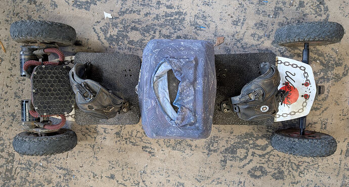

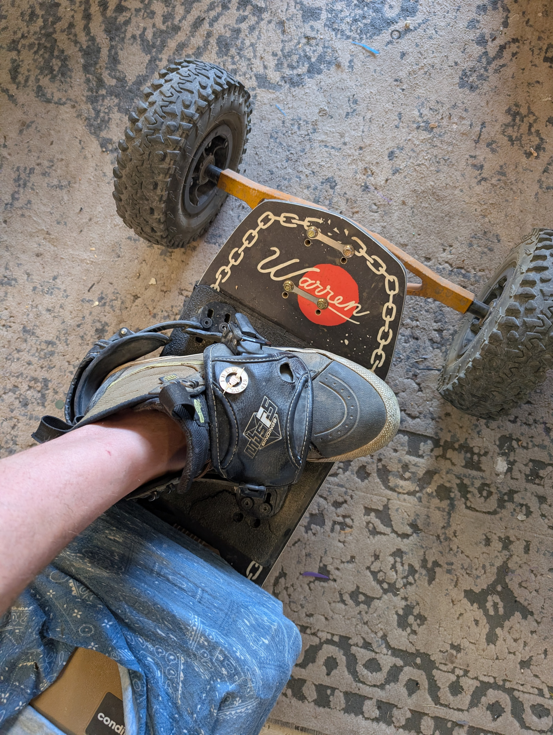

Here are a couple things for some MBS decks.
TPU Dylan Warren III Stomp Pads
Files:
DWIII Stomppy.FCStd (183.8 KB)
DWII Stomppy.stl (424.1 KB)
DWIII Stomppy.step (163.0 KB)
Why make new ones?
@Regular_Michael designed a set that I have been using for quite awhile in this post.
MBS Pro Warren III - Riser Pads - Stomp Pads ​=sirvesa
They are super nice for wire routing and when printed in TPU with the right settings, did help with some foot vibration riding off road. Only problem I had with them is they were a little too small for my feet.
I wanted to make a set that kept a little more of my foot carrying the weight.
What Changed
-The pad is now a little wider than the deck, overhanging it on each side by 10mm. These overhangs drop and grab the side walls of the deck to keep them from flexing too much.
-The footpads are symmetrical and have holes for both goofy and regular setup. You can add inserts and swap bindings around if loaning to someone. It makes a great layout template for drilling them too.
-My feet are not angry at me after riding this board. They’re really comfortable.
Printer Settings
Printing Overture TPU through a .6mm nozzle
Nozzle temp - 227
Bed temp -35
Line Width - .7
Layer Height - .36
Speed - 30mm/s (20 for first layer)
Volumetric Flow - 4mm
Fans on
Infill cubic @ 40%
3 Walls and shells
One Note
They fit my original DWIII perfectly. There’s a 3mm gap or so on the deck grab parts on the switch DWIII. Not sure if it was actually designed narrower or if there’s just some slight tolerances in the decks. Not really noticeable standing on it but might be worth checking with a shallow print or measuring first. It would be easy enough to bring the walls in a bit.
